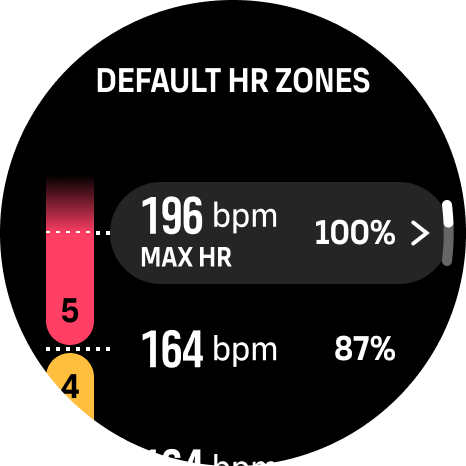

Max HR zones
This is the default zone type. We recommend that you use the max HR zone setting in case you do not know your lactate threshold heart rate and your resting heart rate.
  1. Go to Activity & Training > Intensity zones > HR zones > Zone types.
  2. Select the Max HR zones option by tapping on it or pressing the crown.
  3. Scroll down and select the Default HR zones for all sports, the Running HR zones or the Cycling HR zones option.
  4. Tap the max HR (highest value, bpm) or press the crown.
    max HR
  5. Select your new max HR by swiping up or down or by turning the crown.
  6. Press the crown to confirm the selected value.
  7. On the pop-up screen, confirm if you want or don't want to update all HR zones based on max HR.

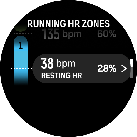

HR reserve zones
We recommend that you use the HR reserve zones setting in case you do not know your lactate threshold heart rate but you know your resting heart rate. Your HR reserve value equals to your max HR minus your resting HR value.
  2. Select the HR reserve zones option by tapping on it or pressing the crown.
  4. Select the max HR at the top of the scale by tapping it or pressing the crown.
  7. Select the resting HR at the bottom of the scale by tapping it or pressing the crown.
    HR reserve
  8. Select your new resting HR by swiping up or down or by turning the crown.
  9. Press the crown to confirm the selected value.
  10. On the pop-up screen, confirm if you want or don't want to update all HR zones based on HR reserve.

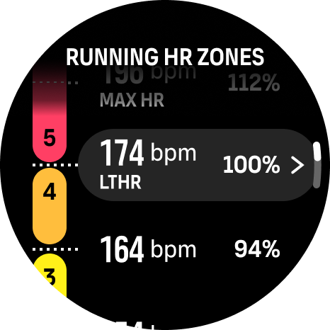

Lactate threshold HR zones
We recommend that you use the Lactate threshold HR zones setting in case you know your lactate threshold heart rate.
  2. Select the Lactate threshold HR zones option by tapping on it or pressing the crown.
  4. Tap the lactate threshold heart rate (LTHR) value or press the crown.
    LTHR
  5. Select your new lactate threshold HR by swiping up or down or by turning the crown.
  7. On the pop-up screen, confirm if you want or don't want to update all HR zones based on lactate threshold HR.

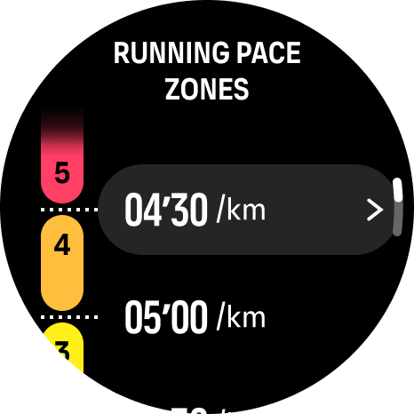

Pace zones
Pace zones work just like HR zones but the intensity of your training is based on your pace instead of your heart rate. The pace zones are shown either as metric or imperial value depending on your settings.
Suunto Run has five default pace zones that you can use or you can define your own.
Pace zones are available for running.
Set pace zones
Set your activity specific pace zones from the settings under Activity & Training > Intensity zones > Running pace zones .
  1. Swipe or turn the crown and select pace zones.
  2. Swipe up/down or turn the crown and press the crown when the pace zone you want to change is highlighted.
    pace zone
  3. Select your new pace zone by swiping up/down or by turning the crown.
  4. Press the crown to select the new pace zone value.
  5. Swipe right or press the lower button to exit the pace zones view.

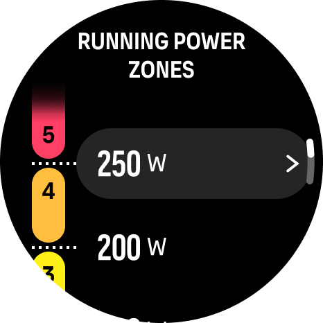

Power zones
Power meter measures the amount of physical effort needed to perform a certain activity. The effort is measured in watts. The main advantage gained with a power meter is precision. The power meter reveals exactly how hard you really work and how much power you produce. It is also easy to see your progress when analyzing the watts.
Power zones can help you train with the correct power output.
Suunto Run has five default power zones that you can use or you can define your own.
Set activity specific power zones
Set your activity specific power zones from the settings under Activity & Training > Intensity zones > Running power zones or Cycling power zones.
  1. Tap the activity (running or cycling) that you want to edit or press the crown when the activity is highlighted.
  2. Swipe up or turn the crown and select power zones.
    power zone
  3. Swipe up/down or turn the crown and select the power zone you want to edit.
  4. Select your new power zone by swiping up/down or by turning the crown.
  5. Press the crown to select the new power value.
  6. Swipe right or press the lower button to exit the power zones view.

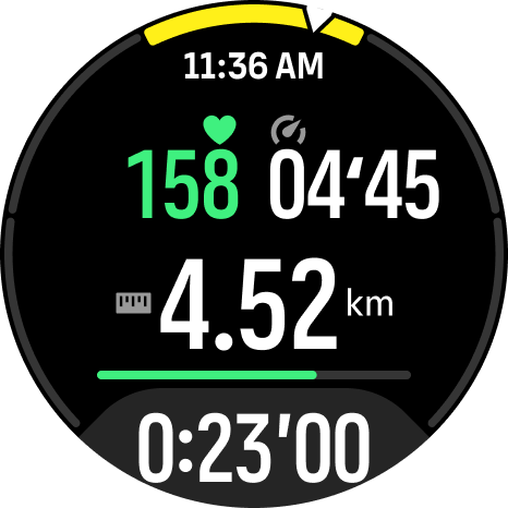

When you record an exercise (see Recording an exercise), and have selected HR, pace or power as an intensity target, a zone gauge, divided into five sections, is viewed. These five sections are shown around the outer edge of the sport mode display. The gauge indicates the zone you have chosen as an intensity target by lighting up the corresponding section. The small arrow in the gauge indicates where you are within the zone range.
intensity gauge

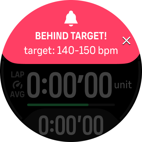

Your watch alerts you when you hit your selected target zone. During your exercise the watch will prompt you to speed up or slow down, if your current HR, pace or power is outside the selected target zone.
