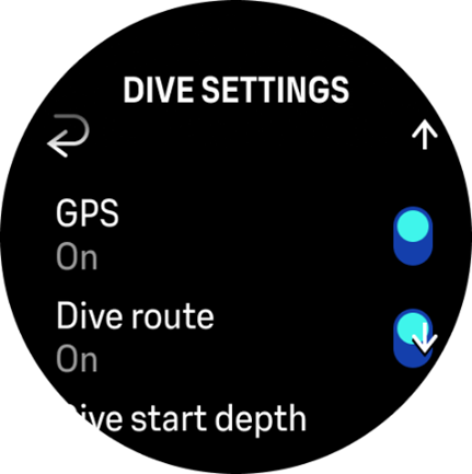

GPS
To track the start and end point of your dive and to get a more accurate dive route, you need to enable GPS in the Dive settings. Make sure the GPS arrow icon turns green in the pre-dive screen before starting your dive to get an accurate location. Suunto recommends you always start your dive from the pre-dive screen.
NOTE:
If you start your dive from any other screen utilizing the automatic start function, the GPS signal won’t be found.

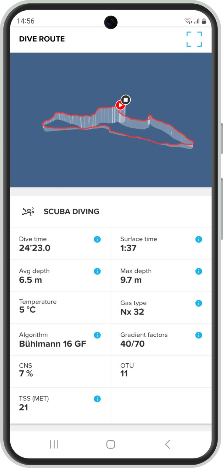

Dive route
You can track your dive route with Suunto Ocean. The underwater route tracking is based on GPS, accelerometer, gyroscope, magnetometer and pressure sensor. The algorithm has been developed by using large amount of data from real dives, data analytics and machine learning.
To track your underwater route while diving, you need to enable both the GPS and the Dive route settings. The dive route is not visible in your dive computer. It will be synced to your dive log in Suunto app when connected to your mobile phone.
dive route suunto app
Note that the dive route signal can be compromised in the following situations: overhead environments like caves or wrecks, indoor pools or with poor on nonexistent GPS signal.
NOTE:
To track your dive route, you need to start your dive from the pre-dive screen and ensure your GPS signal is green. See Pre-dive screen and dive options.
NOTE:
Syncing your dive route to Suunto app might take some time due to the large amount of data.
