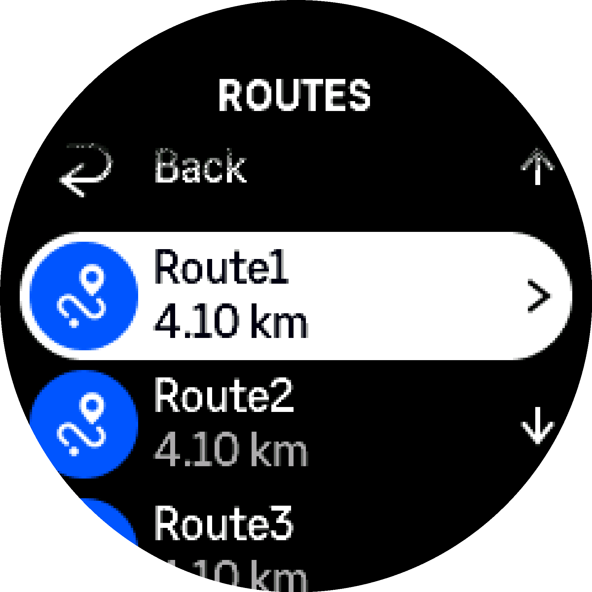

  3. Scroll to Routes and press the crown to open your list of routes.
  4. Scroll to the route you want to navigate to and press the crown.
    Routes list S9PP
