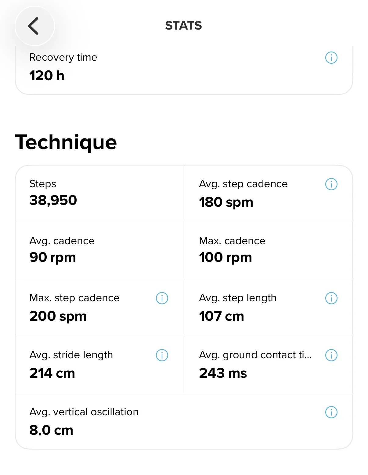

GPS running watches, smartwatches, foot pods, and some heart rate straps can record running cadence. Many devices automatically track cadence and display both real-time readings and post-run data.
SPM (steps per minute) typically counts steps taken by both feet. Some devices or platforms may instead use RPM to count complete step cycles based on one foot. With that counting method, 90 RPM equals 180 SPM. Always check which units your device or platform uses.
Calculation methods and accuracy can vary between devices, so try to use the same device when comparing cadence data across runs.
For a more detailed look at your runs, the Suunto app lets you review recorded cadence alongside other workout metrics.

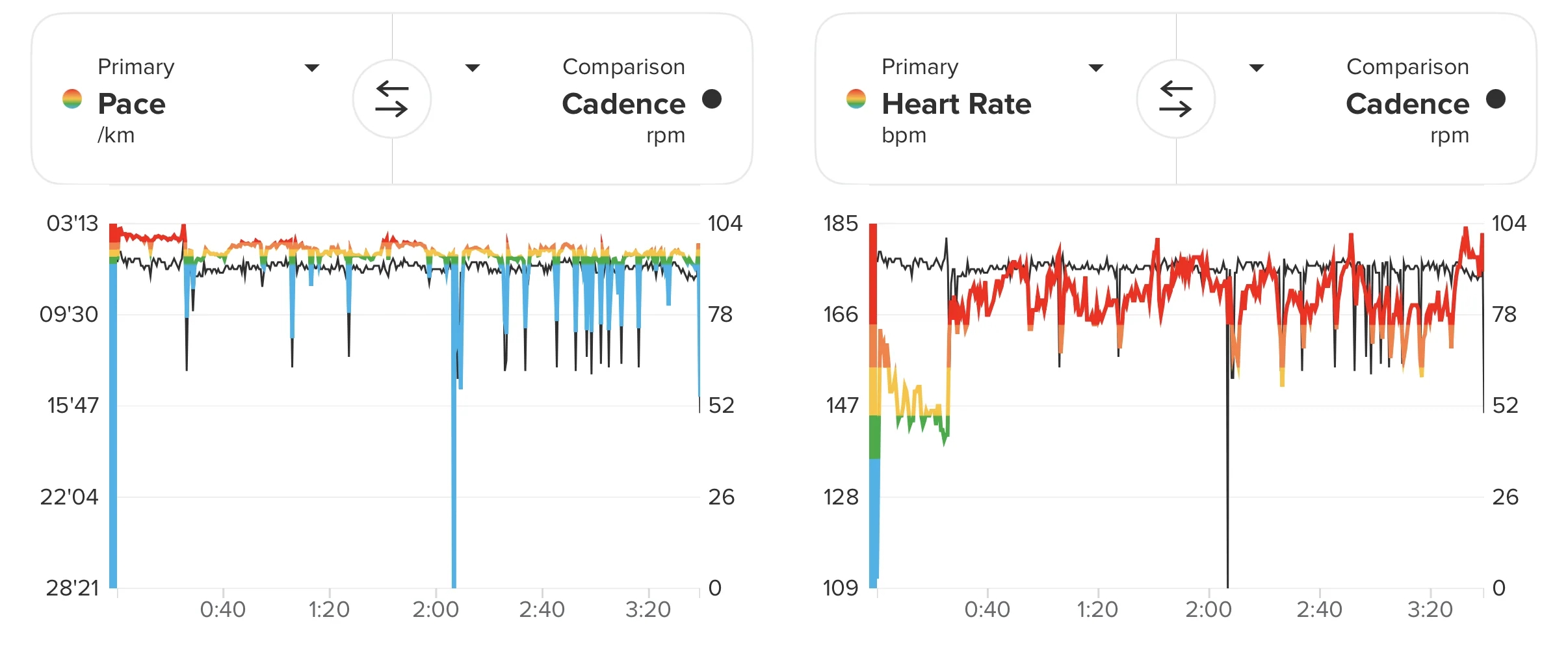

Current vs. Average Cadence
Current cadence is your step rate right now, or over a short, recent window, depending on your device. It moves as you speed up, slow down, hit hills, or shift between parts of a workout. It's useful for spotting clear changes in rhythm mid-run, not for summing up the whole session.
Average cadence summarizes your step rate across a full run or a specific segment. An average of 170 SPM doesn't mean you held 170 SPM the whole way. Your cadence will have risen and fallen at different points.
Before comparing averages, check whether each one covers a full run or a single segment. The average for a workout with a warm-up, fast intervals, and recoveries spans a different stretch of running than the average for one fast interval, so the two can't be compared directly.
Cadence Trends Over Time
Trends show recurring or sustained changes across runs in similar conditions, not a single figure from one workout. The most useful comparisons come from runs with a similar pace, route, elevation profile, and training goal.
Say your cadence usually sits between 168 and 172 SPM on easy runs over flat routes at a similar pace. One slightly higher or lower reading is nothing to read into. If you see a consistent shift across comparable runs, look at your pace, heart rate, and how you felt to understand what's behind it.
The value of long-term tracking is learning how your own rhythm evolves, not measuring yourself against someone else's cadence or a fixed standard.
