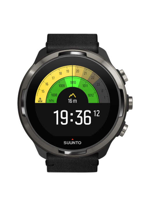

SuuntoPlus Weather
Whether you’re out hiking, trekking, ultra running, climbing or mountain biking, it’s wise to track the weather and environmental changes. That way there will be no unpleasant surprises. The Weather insights SuuntoPlus feature on Suunto 9 Baro helps you to do just this. It gives you a heads up on the conditions while you’re out there.
A combination of functions – storm alarms, temperature readings, barometric trends, sun and moon phases and more – give you the intel you need to make smart and safe decisions in the outdoors. Here’s an overview of the weather insights you’ll get:
Sunrise / Sunset
The upcoming sunrise or sunset, depending on which is next. This tells you when to pack up and get going, for example, or how much daylight you have left to finish your activity for the day.
Temperature
Take your watch off to avoid your body heat skewing the results, and place it on something to get an accurate temperature reading.
To get a water temperature reading, place it underwater (below 10 cm/ 4 inches). After you remove the watch the temperature is shown for 30 seconds, and is indicated with a separate temperature icon.
NOTE: Measuring the water temperature will affect the ascent/descent values as these are pressure based.
Estimated time of arrival (ETA)
If the estimated time of arrival goes past sunset, it will be shown in red. This gives you heads up on how you are doing for time, whether you need to speed up or have enough slack to cruise.

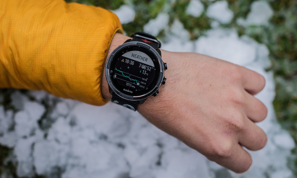

Barometric trend and storm alarm
The barometric trend is shown on the bottom of the screen, with the current barometric value. The Suunto storm alarm is automatically shown if the pressure drops 4 hPa (0.12 inHg) or more during a three hour period.
Oxygen level
If you are above 2000 m (6 561 ft) your watch will give you a reading on the oxygen % compared to sea level.
Read how to use Weather on your Suunto 9 Baro here.

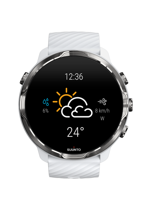

MyRadar
Get sophisticated weather forecasts on your Suunto 7 with MyRadar, a free Wear OS app. MyRadar has two components; conventional weather forecasting and also an impressive high definition radar display of your location with time lapse shots of the weather fronts moving around your location, as these two pictures illustrate.
The weather forecasting offers hour by hour updates, lightning and weather alerts, precipitation predictions, and conventional daily and hourly forecasting. The high definition view and the accuracy of MyRadar has made it the go to weather app for many outdoors people.
Get the app here.

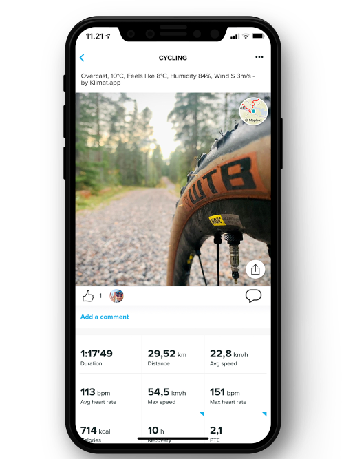

Klimat
This cool little service automatically adds the weather conditions from the beginning of your activity to your training log. No need to install anything on your phone; just sign up online and you’re in business. It allows you to look back and see when you braved the rain, or were out in that last horrendous storm.
You can choose the data and style, including emoji preferences, set the format and label it according to your purpose or aim. For an extra $5 a year, you get everything the free membership offers, plus some useful additional features such as air quality data, location info, and the removal of branding.
Start using Klimat here.

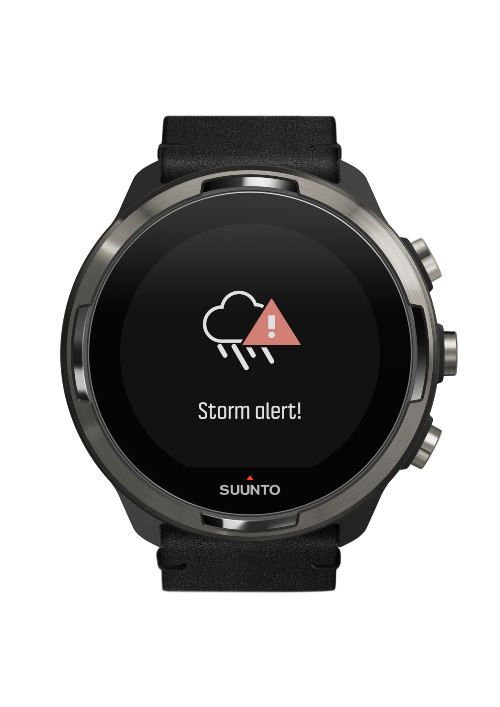

Storm alarm
A significant drop in barometric pressure typically means a storm is coming and you seek shelter. When the storm alarm is active, your Suunto 9 Baro sounds an alarm and displays a storm symbol when the pressure drops 4 hPa (0.12 inHg) or more during a three hour period.
Activate Storm alarm in Settings -> Alarms -> Storm alarm. Learn more about storm alarm on Suunto 9 Baro here.
When your storm alarm sounds, pressing any button dismisses the alarm. If no button is pressed, the alarm notification lasts for one minute. The storm symbol remains on the display until the weather conditions stabilize.
